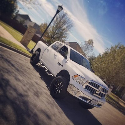

lone12star
Jan 16, 2013
1,061
136
Kyle, Tx
I’ve been thinking about swapping mine out for Nfabs 39ec4988e2960616328d680ab3637471.jpg
