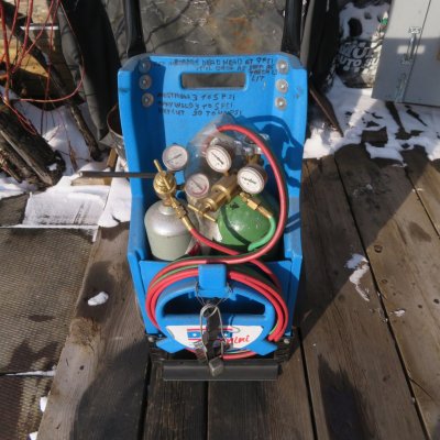

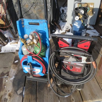

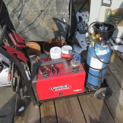

My little Lincoln 140 is going on a dozen years old now,and has seen a fair bit of use.It's still a good little welder when you use gas. If you're just a hobbyist welder ,you can also pick up one of these little cutting torch kits,you don't need a contract to fill the bottles,is it's best selling feature.

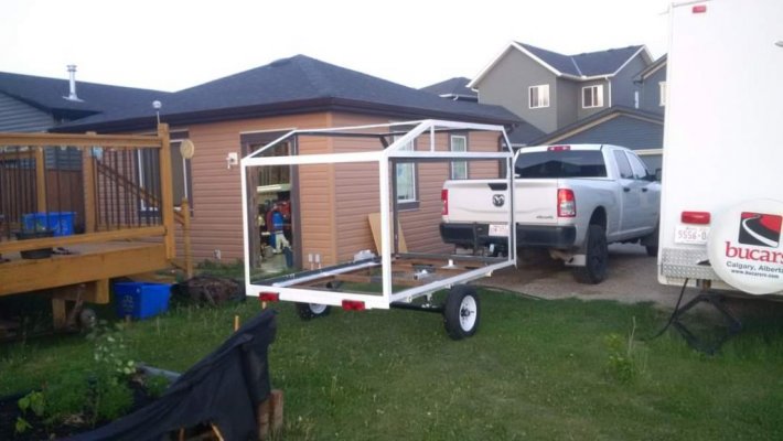

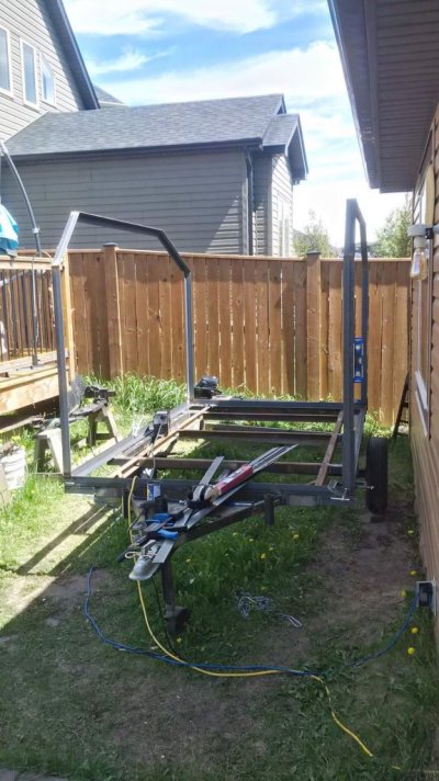

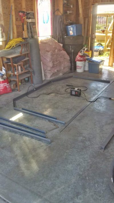

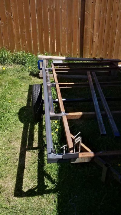

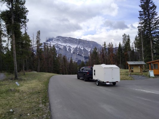

We need more pictures of the trailer.That's impressive for a little 110 volt mig
Stick. Used 3/32 7018 and never tripped duty cycle or the 15A garage outlet breaker. I don't use a welder at home too often so I didn't see the need to spend a fortune on something fancy.

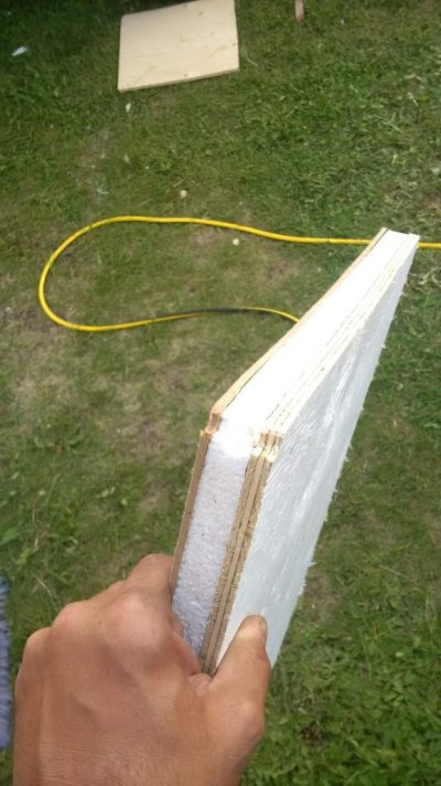

Here's a thread hijack photo dump!
The trailer weighs about 1300lbs with 160lbs tongue weight. It rides on a brakeless 3500lb axle, 1250lb springs, and 145R12 load C tires with an 80mph speed rating. The steel is part recycled tent trailer frame and 3/16x2" angle. The springs are mounted to two 1x2"s welded together to 2" square runners. It's fully insulated on 6 sides. The bed is a 60-80 queen.
View attachment 511316View attachment 511318
Now that's awesome. I like the fact you put it all together yourself,way to go. :waytogo:
