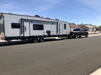

Here is my trailer. This trip it’s loaded heavy around 13k. Truck is a 6.4 with 34” tires and 4:88 gears. Up Sherwin pass in Bishop trans never got over 180.
truck tows with ease, except the fuel mileage 5.7mpg
