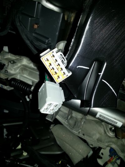

Here is a photo of what I'm talking about. There is the big connector and small connector. They were tucked up in the dash above the gas pedal and wrapped in foam. The one I blew is the small 4 prong connector. Don't know what it would be under in the fuse diagram in the manual. Anyone with a name or the actual fuse number will earn the award of favorite member of the forums. 9286730e4a9522313dd56fe422d91cc4.jpg

I'm not at work right now so I can't look up the service information, but I would just grab a test light and check all the fuses under the hood. It'll only take a minute.

I found it literally an hour ago. It was F11
I want to hardwire my dash cam as well. So this 4 pin harness has constant 12V and a switched 12V on it?
