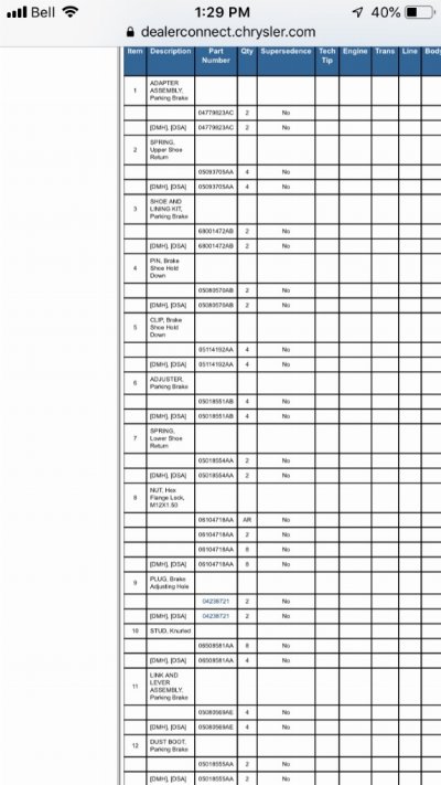

Dark Knight 500
Nov 25, 2017
276
217
Alberta
Straight from the fca parts catalogue0ea9eaba8e0df24f532f80c43ab23906.jpg243da534995fafc7b6ae229421e68548.jpg

Check out this If U got a good SA at dealership, should be no problem: All this IMHO::
LEVER--LINK--LEVER-ASSEMBLY--LINK-AND-LEVER-ASSEMBLY-Right-or-Left-Park-Brake--Parking-Brake/6704419/05080569AC.html FOR 2014 2wd SLT..
DARK KNIGHT above post has it: U just need to order specific part for your YEAR truck, as different years have same part ### except for last (2) letters...
I WOULD GO WITH THE MOPAR BEFORE DORMAN, JUST MHO:
https://www.moparpartsoverstock.com...-Brake--Parking-Brake/6704419/05080569AC.html
