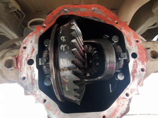

We got a storm and the temp dropped to around 100, so I just did the diff. It looked totally fine from what I could tell. No shavings, no glitter, looked very good inside. Took forever to get all that rtv off!
Installed a new lubelocker gasket, torqued the cover to 30 foot pounds, and filled with 4 ounces Mopar friction modifier and about 2.5 quarts valvoline synthetic 75w-140.
I still need to go for a test drive but I'm hoping this makes a difference in the noise.

You didn't need the friction modifier as you have the open non limited slip diff,but it doesn't hurt to add it either.
That doesn't look like a stock ring gear,i'd say at some point in time it was re-geared
I agree on the ring gear. Maybe the lash wasn't set properly and that is where the noise is coming from?

The vin decoder says I have a limited slip differential, but I don't know for sure. My truck is a 2010 1500 4x4.
You think it was re-geared? I've had the truck for about 6 years so it would have been before me. If it has been re-geared that means I have no clue what the gear ratio is. That's not a great surprise!
