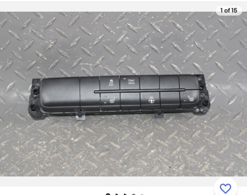

I currently have a 2019 ram 1500 classic tradesman and I just bought a rough country front bumper with a light bar and a few other lights the panel I currently have in the truck has no where to wire an auxiliary switch into. And I would like to run the light switches into that panel. It currently looks like the photo i attached. The question is do I need a whole new panel with new auxiliary switches and if I do can I move the location of the heated seats and steering wheel so that if I need a new panel I will still have the heated seat and steering wheel buttons. Any recommendations would help.

You can swap out, you'll have to do some reprogramming I think, search the forum for aux switch panel. The much easier way would be an added switch panel. I run an Auxbeam, Spod makes a nice one, AEV makes one for above the radio, you have other options than redoing the factory switch panel.

To change that button panel out to having Aux buttons on bottom row you'll have to add a different panel, a wiring harness and do some Alpha OBD changes as well to get that to work. There used to be a site that had that mod kit to add on Aux buttons with harness, but I can't seem to find it. Anyone else have that? Maybe it's no longer, not sure
As far as relocating the other buttons to where you top row blanks are (if I'm understanding you Q correctly) I don't think that is possible. Other threads I've seen doing the add on aux buttons would use the on screen controls having the Uconnect already. Maybe others will chime in with additional ideas that I'm unaware of.

There is a complete post, in fact the whole thread is about how to disassemble the auxiliary power panel & reassemble it with different buttons.
I think the last time i saw it, the member was having an issue with some kind of sticky liquid that was making the buttons hard to function

As "danielmid" mentioned, it is much easier to add an auxiliary switch panel. The Ram switch panel is nice, but you will also need the relay box as well, and more work to install. Do a search, and you will find additional information on this subject. I have a Spod system, not cheap, but works well.
