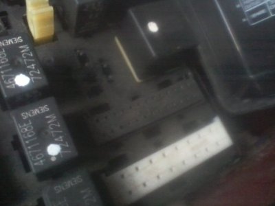

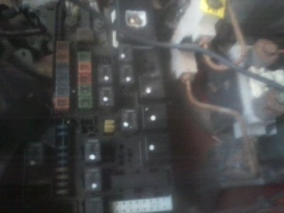

Am i missing circuit breakers in my junction block? the power windows use a circuit breaker.

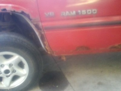

also, power steering fluid leak. drips near driver side front wheel.

i can not find the circuit breaker for the power windows. The tan wire that feeds voltage to the switch is dead.
Where would it be?
