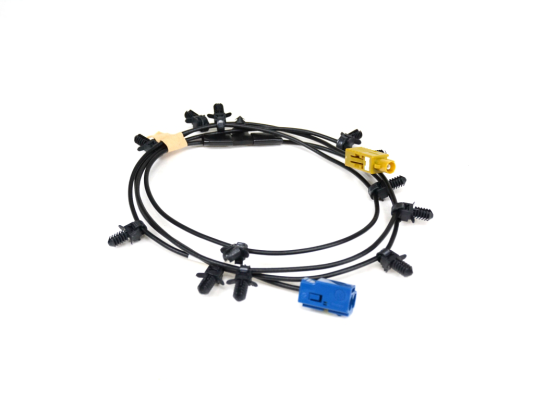

Hello Benny! Wondering if you can help me out here. I took my headliner off to apply dynamat and dynaliner to the ceiling. That all went well, but I made two mistakes. While cutting one of the mats, I cut the end right off my puck antenna. But before I did that, I managed to pull the crimped end out of the truck-side of that same connector. The end came out and the pin immediately broke off. So now I need to replace the interior SDARS cable with the mustard-colored plug. I think the part number is 68148278AD, but I'm here to ask you to confirm. While I'm replacing that cable, I'd also like to put the shark fin on the cab and replace the now-broken puck. Can you give me a part number for that too?
I found this (old) pdf that talks about relocating the antenna helpful, but I still need your guidance to be sure. https://www.ramtrucks.com/BodyBuild...jGgHzAHGUTU0WB3rWuqSY7YmQ2vEhuBWBGCpmJ39kiY/
2021 1500 Classic Crew Cab, VIN 1C6RR7TTXMS516931

Hi,
I believe the cable is 68170083AB
If you follow it down to the other end you should see a Blue Double connector. It would take us 10 days to get
Please let me know if you have any other questions.

Can you confirm the shark fin part number I should order? My truck has the second wire (with blue connector I believe it was). I understand it won't do anything except look cooler until I replace/upgrade the uconnect system.

Based on your VIN the truck does not have a shark fin, It has a flat style GPS/XM antenna part # 68328996AA
