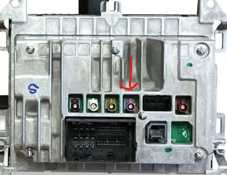

When I was uninstalling my 8.4 to replace with this Junsun, I noticed that the pink connector was broken (plastic surround broken off), and the cable was no longer connected. I am pretty sure that is the 3G Antenna for the Uconnect services.
If Junsun can't fix my issue I'd like to go back to the 8.4, but I'd like to fix mine if possible. The main issue is that the radio would randomly freeze up, and it did it more when it was either extremely hot or cold. In ~70 degree weather, the radio worked fine 99% of the time.
If this is the Uconnect antenna, I would assume that it means they can't push updates to the radio properly, but I dunno. So, 2 questions:
1) Would this broken connector be reasonably easy to replace on the board, and can I even get it?
2) Is it reasonable to assume that maybe the radio sees something randomly connecting/disconnecting and causes it to freeze up?

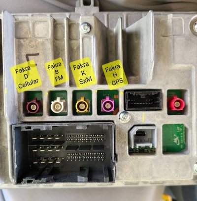

It's the GPS antenna input which isn't really needed... Radio can use the SXM antenna input for that (mustard/curry).
Replacing the connector/ lock isn't really a practical option, but you can get 6-8" pigtail adapter/extensions that work well to allow a connection if you really need to use it. See examples here
Replacing the thermal pads inside the radio may help.... SnK also added fans behind the radio...
Reference’s to help (see SitKneelBend’s info at RamForum where you can find it)
>> How To: Install a 2018 4C (UAQ/UAS) Radio POST 3051
>> He recommends replacing the original Thermal Pads while you’re in there, I did (Arctic Thermal Pad 145 x 145 x 1.5 mm - Silicone Based Thermal Pad).
>>> Some of my posts 8.4 Uconnect touch screen delaminating Post 209 and Post 223 about it.
