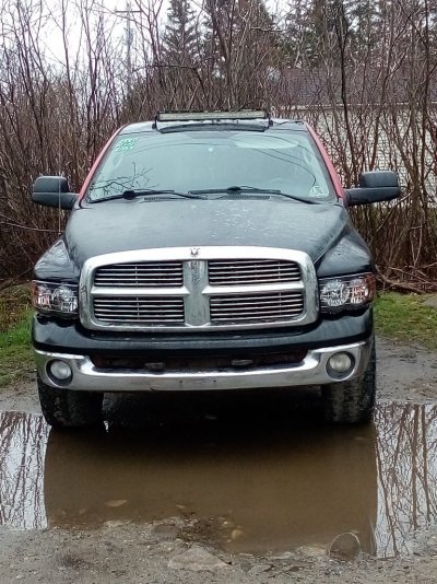

Alright I need some help with my hemi. Took it out for a long drove one day went to start the next day and something didn't seem right by how it started sounded right bogged out with the muffler. At the same time there is a bad shake in the motor my first thought was check my spark plugs and wires had all replaced, still happening next I changed out coilpacks and pcv sensor along with a new throttle body and new map sensor. But still getting the same shake and rough drive and when I put my foot to it you can hear the intake sounds like it is sputtering. Should j be looking into injectors and air leaks next or am I missing something else
