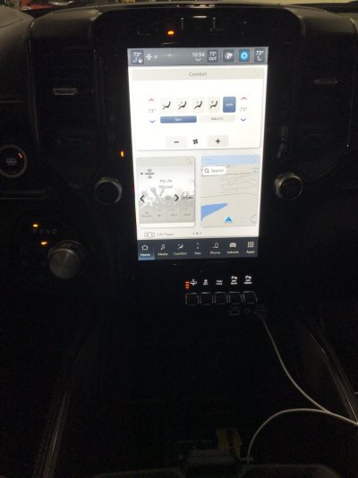

I just got a 2026 Laramie Hemi with 12 inch screen . This is driving me crazy. See the attachment. My nav map only shows on top part of the screen. My dealer had a heck of a time getting the bottom part to go away and i didn't see what she did. It was ok until i shut off truck then restarted the next day now it is back to what you see here. I can't figure out how to make bottom part of screen disappear again and i want to stay gone i don't need the short cu 32.jpgtoption to pop up. Any ideas guys?

I think it will go away if you tap the NAV button at the bottom which should give you a full navigation screen view. The squares in the HOME view are for adding preview screens (widgets) like your radio selection, HVAC (Comfort) settings etc. see my HOME screen below. I had to spend a day going through the manual on my 23 figuring out how all that needed to be set up and the steps involved and then I went out to the truck and worked my way through everything setting up my preferences. I hope they gave you a printed manual. I heard something about those going away in favor of an on-line version. :rolleyes:

The two dots to the right of the "Edit Page" indicate there's another screen. What happens when you swipe left? Also agree with trying the NAV menu to get a full screen NAV. What happens when you select the symbol in top left of each screen (the squares with arrows in upper right corner)?
My 2021 has an X in the upper right of the double pane to close one or the other. Do those symbols with the circle-slash close the pane?

The symbols in the upper-right corner of the windows look like minimize options.
Have you tried tapping them?

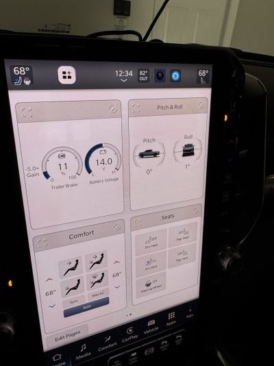

You have the "Home Screen" up and it is not configured yet. The Home Screen is designed to show "Widgets". Widgets are logical collections or groupings of applications and/or functions. To get started click on one of the boxes with a + sign to begin adding a widget to your Home Screen. Next select the applications shortcuts you want in that widget and where on the screen you want the widget to appear.
My Home Screen is shown in the first image below. At top is the "Car Play" widget showing Google Maps, Bottom Left is "Now Playing" widget showing what is playing on the radio, and Bottom Right is "Short Cuts" widget showing a collection of applications icons. I selected the apps that I want to show up in the Short Cuts widget, i.e., the ones I might use the most frequently.

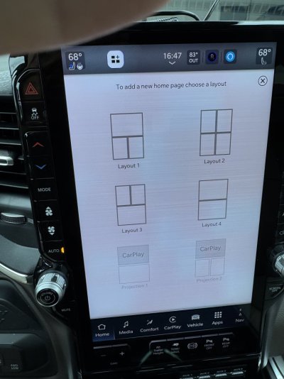

The initial choice of widgets is shown in the second picture. I think this shows up if you click on one of the + signs on the screen you showed. You can select a pre-created widget, or create a new widget, name it, and then you can customize or modify what is in it.
At the bottom of the Home Screen are two dots. This means you can swipe to the Left and set up completely different set of widgets on a second version of the main Home Screen. Swipe to the Right to return to the first Home Screen.
My second set of widgets is shown in the third picture. You can see I have created three groups of functions or widgets.
So...Click on one of the plus signs and start playing with it. You cannot hurt anything. You can change and rearrange things at will. There may be a learning curve but will get the hang of it.
Remember there are dedicated buttons on the bottom for Media, Comfort, CarPlay, Vehicle Settings, a Listing of all Applications, and the built-in Navigation System. If you want to use WAZE, Google Maps, Apple Maps you need to use CarPlay.
The Home Screen comes basically blank. It is for you to customize what functions you would most often use of like to see on the center screen. If you do not want to configure the Home Screen, then select one of the other choices at the bottom like CarPlay or Media. But, when you get tired of hunting around for functions under Vehicle or Apps, then you may realize what the home screen is good for. It is really not that difficult.

Thanks everyone! danAR hit the nail on the head, once i was underway i hit nav button and got nav on the entire screen. Thanks Eric Troup. I did try the 2 dots on bottom but did not solve the problem while at a stop looking at nav screen. But now while at a stop ihit nav button and got full screen as well as when driving. Don't know why it is giving full screen now when did not before but at least problem solved for now

The two dots do not do anything yet because you have not selected and configured any widgets to appear on the Home Screen. All you have are two unconfigured screens that look the same.
Hi, that "circle-slash" as you put it, is the edit button. It's a circle around a pencil with an eraser on it.

How did you get CarPlay to the Home Screen? My preselected widgets looks just like yours and there’s no option for CarPlay. I see you wrote create a new widget. Where is that option? I haven’t seen it on mine and I don’t see it on the picture you showed. What am I overlooking?
Well, I do not remember exactly. I just played around with the interface until I liked it.
Make sure CarPlay is working and connected before you edit the widgets. Bring up an app like google maps, apple maps or Spotify.
See the photo sequence attached.
1. Select "Edit Pages" at lower left.
2. Next select "Add Page" on the pop up menu
3. Select the Layout - I think I must have selected "Projection 2" which shows CarPlay at the top.
Then I think you edit what apps or shortcuts go in each widget / box.
Try it.
