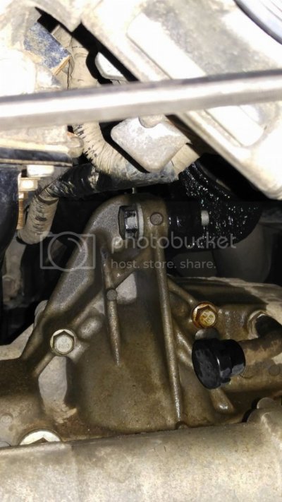

so i got all of that apart with a air chisel and a vice grip.
But i got almost no where today. Im stuck on the stupid ******* differential bolt. Top front bolt, there is no way to really get to it? Its stuck in place, i tried a cheater bar, right angle air gun, wrenches, i dont know what else to do, it wont budge and i cant get enough movement to do much.
Thats from the front of the truck between the front crossbar and the engine. Right next to it is the oil pan

You're not attempting to do this by yourself are you? As in no help?
If I'm not mistaken, I used a long extension with a swivel on the end of the socket and used a pipe on the end of my breaker bar. Couldn't fit my impact gun in there. If that doesn't work try heating up the bracket with a torch first. I think that bolt and the upper rear shock bolts were the toughest to get at.
ill try doing that, i was using a ratchet and a big pipe, maybe i need to get even more leverage

Spray that ******* with PB Blaster too, works better than WD40.
i loaded it up with pb to sit over night, ill throw some more on tomorrow too
