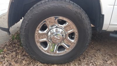

I swear I searched but didn't find what I was looking for, for my specific truck. So here's the deal... I recently bought a 2014 2500 Heavy Duty Tradesman with the 5.7. I already installed a legmaker carbon fiber intake tube, K&N filter, pedal commander and Diablo intune 91 CAI tune. It currently has 275/70/18's on it. What's the biggest tire I can put on those wheels? How about the biggest tire I can put on without having to worry when pulling my 30' camper? I have attached a pic of the wheels on the truck since it seems like there are a few different wheels for these things. Thanks for your help!

35/12.5/18 or 305/70/18 will fit with slight rub at full lock on radius arms. Could also go 285/75/18, probably with no rub

Thanks for your reply. That's a huge help!
