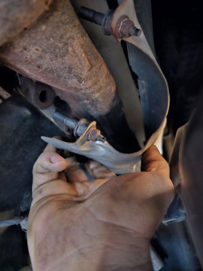

i have a 2017 Ram 1500 4x4 sport. My manifold has two broken bolts on rear passenger side. Looking for recommendation on what shorties to replace it with? any part numbers on bolts to buy. Ill be going with the remflex6022 gasket. I seen some JBA 1-5/8-Inch Shorty Headers on American Truck for $807. any good? any suggestion? I have truck in shop trying to get this done by next week.

Have your oem manifolds milled flat.
Shorties are expensive for negligible gains. unless you just want shiny hot tubes under your hood.
You won’t notice any power increase without tuning. All the normal hemi ticks will become louder due to the thin walls (injectors etc)., heat shields usually won’t fit so under hood temps may go up a bit, fitment usually isn’t 100% so you’ll be fussing and cussing a lot installing them (or the shop will).
There’s tons of threads on here about shorties.
Sincerely,
Someone who has afe shorties (got them super cheap, and still wouldn’t buy again)
Dodge 1500 4X4
Sep 25, 2019
3,134
3,455
Rochester, NY
Get a bench mounted belt sander, and true them yourself, they are inexpensive at Harbor Freight, getting a new one you will have to season it all over again,(heat soak) a good shop will be able to extract the studs by welding a washer and nut on the hole, don't let them use a bolt extractor on the stud they can cut into a water jacket and the head is destroyed.
