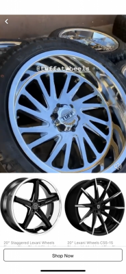

I just got a RAM 1500 Big Horn 2019. I'm looking to get a wheel and tire package running Nitto Ridge Grapplers for a smooth ride with a little lift without any rubbing. Also I don't want any interference with the speedometer or the TMPS. I'm new to the world of full sized trucks and need all the help I can get. So any and all would be appreciated. Also I was looking at some Chrome TUFF Wheels 22's they look pretty sweet and would look awesome on the "Big Horn".

To Maddog and LeesEvoX, I thank you both so very much for your input and your information. I have an old military mentor of mine who has the same truck and his wheel and tire package is 33x12.5 x20 "Nitto Ridge Grapplers/ MottoFab -24 offset. So after seeing his I'd like the same but was a little caught in between running 20's or 22's. Also I was looking for these Chrome Tuff wheels here.
