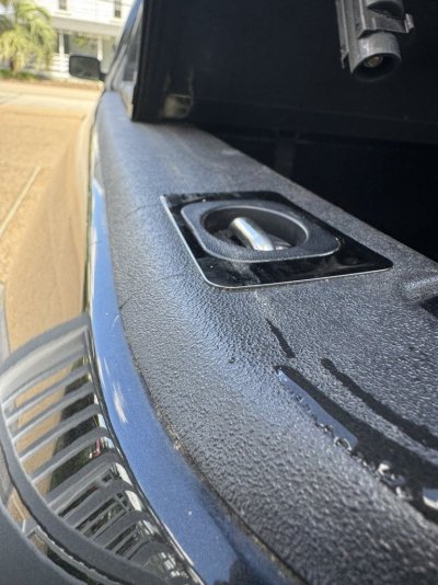

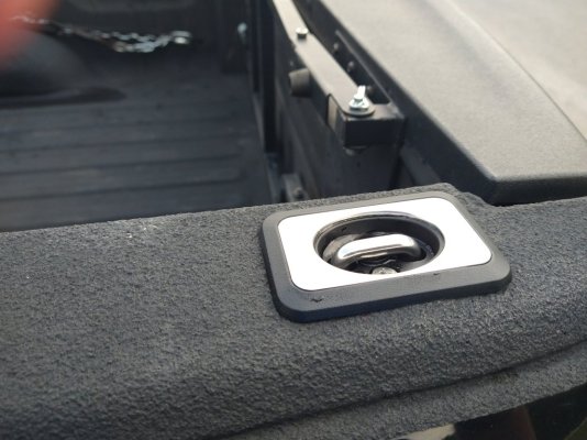

I added rear bullrings to my truck this weekend. Had them on my '05 and really liked them. I hate that I had to cut my truck a little to get them to fit, but I figure they are not ever coming back out. As I have the chrome bumpers, I got these with the stainless trim. If you do not have these, you should consider them. bullring.1.jpgbullring.2.jpg

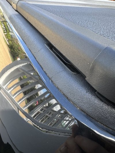

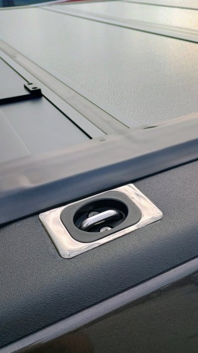

Looks nice but won’t work with my hard top back flap Tonneau Cover...I think the cover runs to close to the edge of your bull ring..might have to try them as the 2 holse are uglyIMG_1653.jpg

where'd ya get them and how do they install?

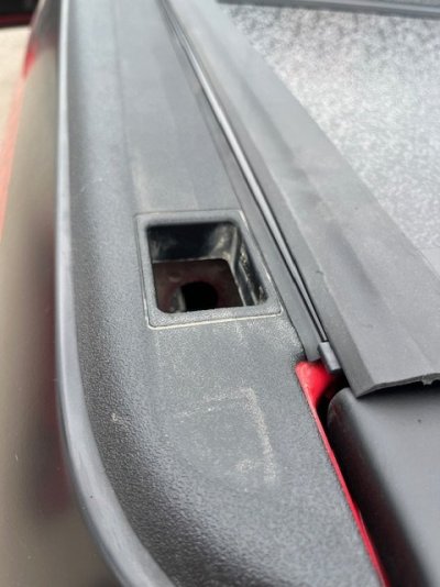

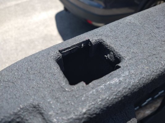

I got them from the RealTruck website. $43 and change for the pair delivered. You have to make a 1" +/- cut in the center of each side of the hole just deep enough (1/8") to remove the plastic cover that sticks down into the hole. I watched a Youtube video for that. I used a metal blade in my jigsaw as I do not have a Dremel. I also went out just now and removed one to show the cut I made. Ugly, I know, but it isn't coming back out so it will be fine. The cuts are needed to allow for the wings on the BullRing to slip down into the stake pocket.

I got those a few years ago and they came with a nifty cutting tool for the pockets using a 1/4" rotary cutter.
Amazon for like $30 I recall.

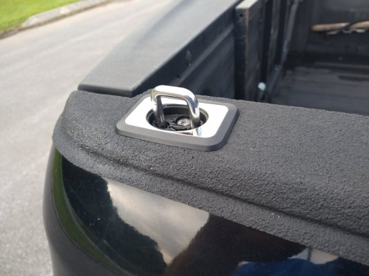

I just added the flush mount ones to my truck. I only had to carve out the plastic top where the ridges are. Came out pretty sweet!!!
