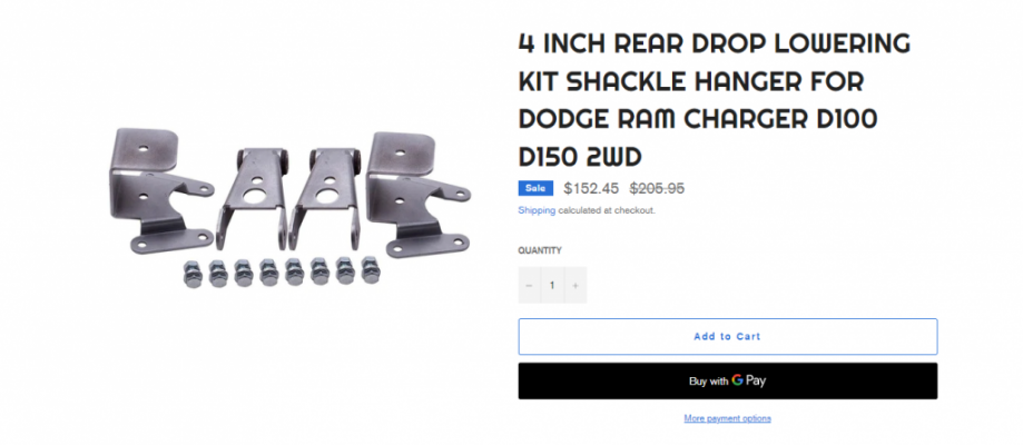

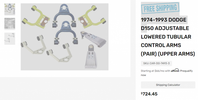

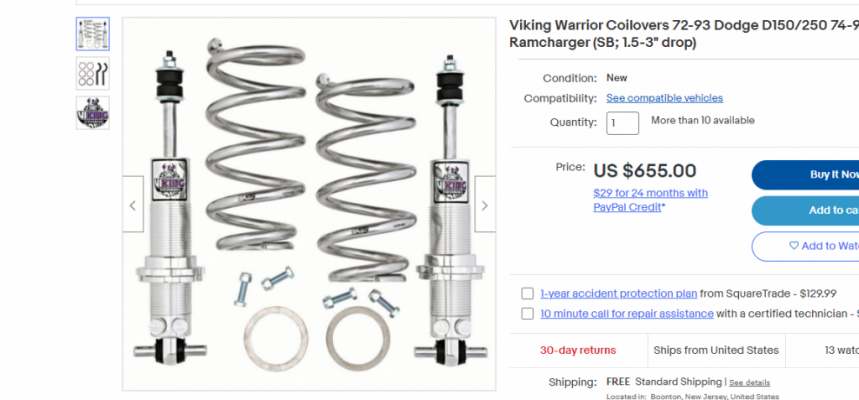

I recently ordered a dynamic performance 4 inch rear drop kit, and a set of QA1 dual adjustable shocks for the rear to start off this build. I'm getting ready to purchase a set of Viking 1.5-3 inch drop coil overs and x2 Industries lowered tubular upper control arms for the front (All parts pictured have attached links).
If anyone has info and/or recommendations on either these coil overs or control arms please let me know!
