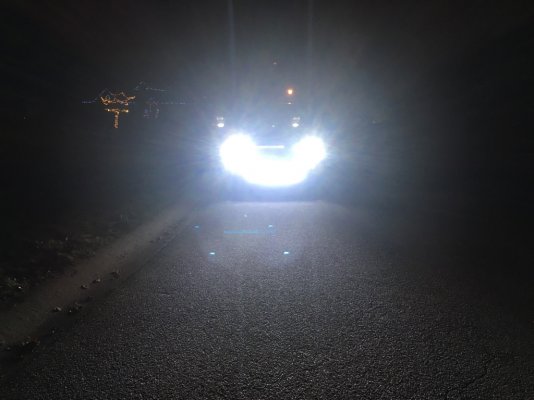

I have opt7 flux in both high low and fog! No issues. Love them!!!!39c06b5e2d1bbf7565fb07cf8086faeb.jpg
