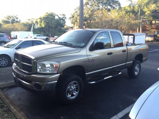

Here is a picture of the truck in Florida before I replaced the tires.

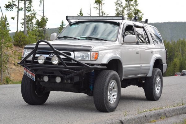

I am no stranger to flipping and upgrading vehicles ( including motorcycles) We all have that one vehicle we love and aware we will never sell. This is mine.
2000 limited 4Runner 5" lift lights everywhere and supercharged running 8 psi of boost.

What size lift do you think this truck has?

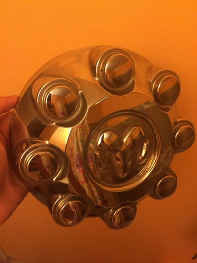

Who has a 8 lug hub cap like this? I need 2 of them. I can PayPal. The cheaper the better!!!

With the picture provided I am going to guess it has about a 2" -2.5" level. Is there a spacer up front on top of the springs? If so, measure that and it will tell you how much it's been leveled.

No there is not. I would have noticed that right off. It's just a full tall spring up front.
