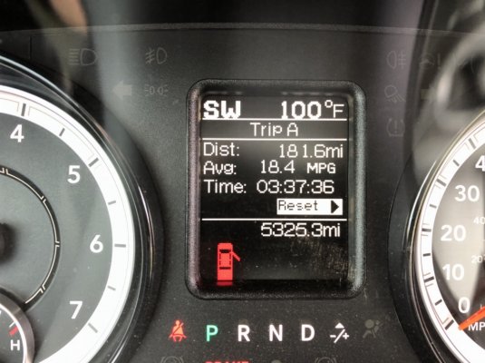

A) I pull my 10.7 loaded camper through the mountains of New Mexico, ele. 4000-10000, with no problems. It works going up the grades but I didn’t expect it to run 70 mph like a Cummins would. I anticipate the grade and manual select a lower gear to keep my ROM in the power band and she runs up the mountains just fine. I’m not in a race at all.
2) what mpg are you guys getting and what conditions? My commute to work is 80% city and 20% hwy.
A) I have the same sort of commute and I’m averaging 14.2. That’s with adding errands in and running kids around town. If I stick to the highway, even with NM mountains in the way, I get 17-18.
3) what is the acceleration like from 0-60? Since it is mostly my DD, I am curious as to what others are seeing.
A) with 4.10 from the factory, it’s a lot of fun, but it is a 7000lb truck so, I’m not expecting it to win any races, but if you are worried about getting up to speed, don’t.

Hwy, no camper: 2832bdb6d8efbc63c28fe84bc070309f.jpg
Hwy with camper and lots of mountains:679c0057ef0dc5d00b4f5bb1fabc4e28.jpg
