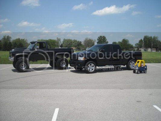

I've had my ram over a year now and the mpg is terrible but it's the best pulling truck i've owned...besides that i'm going to be selling my other baby and need your help. I should get around 10-13k for my other truck and im going to be putting some money in the ram. I want to lift it and do some exterior mods. What would you do with 3k to my truck? Thanks!!!! here is of pic of them both
