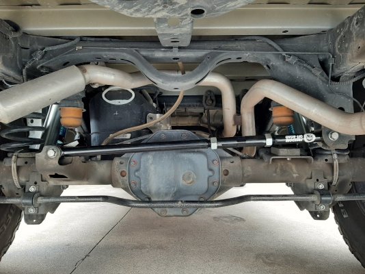

The rear end, while improved, isn't as "perfect" for me. Could be just the 2.5 on the front vs. 2.0 in the rear? Or, the feel of the ICON springs compared to the stock springs? The rear end is just bit more stiff and doesn't feel as controlled as the front, it dances just a tad bit. Possibly track bar bracket help? IDK. .
I have ~2" lift springs on mine (with stock track bar) and felt like the rear was never quite right, too - then installed that track bar drop bracket from Carli. Problem solved! I was best able to feel the difference when taking a familar curved freeway-to-freeway exchange that has a rough expansion joint in the middle of the curve - when I was able to take that corner the first time and not feel that little wiggle from the back I knew it was fixed.
I don't try to talk people into spending money in general if it's not going to actually solve a problem but I believe putting the track bar back nearly parallel with the axle like stock was a major improvement, and at 75 bucks and a quick install not even very painful.
I agree with Kurek on this one. After lifting my rear up almost 2" the Track Bar and extended rear sway links really made noticeable differences for the better. These trucks seem very sensitive to geometry changes, tho each vehicle is different. Ram1500 and Revit both run without Track Bar relocations and have no adverse issues, but I do believe that they both gained about 1" with their setups due to added weight. Considering you're running light competitively speaking it's worth a try, especially if you'll already be under the truck. I'm not one to spend others money un necessarily but for less than $100 I think it's a worthy upgrade.
Sent from my SM-N920V using Tapatalk
Every little thing helps when we consider how flimsy some of our rear parts are made, especifically rear trackbar, rear control arms, rear sway bar, rear sway bar links. Unreal the truck is rated for 10k lbs towing and you can flex your factory trackbar wiggling it with 2 fingers or and you can hold it in your hands with one lol, is like trying to hold an axel together with welded spaghettis :), add big tires to the mix and the extra weight on each corner won't help the cause.
My trackbar is not flat but i don't have any handling issues because of it, i will have one if i was lifted at least 2" though.
I second that. I did the Carli Bracket as well and I noticed the difference over uneven roads. This was before I was running my King's so I can't say how things would compare now.
49664539047_be3b9c9bfc_k.jpg2020-03-15_06-17-09 by RAM RSM, on Flickr
