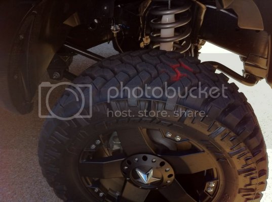

Parents just brought home a new 2012 Dodge Ram 2500. It has the Cummins diesel, and is fully loaded. So many toys! It has already has a 5" lift put on with 35" Nitto Trails put on it. Still working on learning everything about it, any tips and tricks to these 4th gens? Anything at all? I'll be posting any and all questions from my stepdad for him.

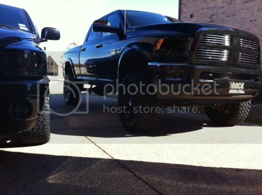

How it will look in a couple weeks +/- a few things:

I probably drive it more than he does at this point. Haha. Love how everything seems so small with the lift.
