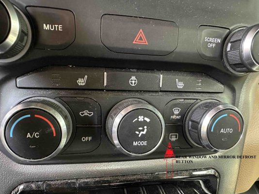

The wiring for both the motor and the rear window defroster are in the control unit that goes from vehicle wiring to the window. I had mine replaced in Feb 2024, but I have the rear window option. If you do not, then it just not gonna work, nothing to route power to the heated "lines", ... IMHO.
NOTE in PIC: THE BLACK controller hanging in between the (2) wires, that is the control module and motor control that runs your rear slider window and the heated window strips. IF U did not have it already wired in, highly doubt you will have that option (rear defroster) available. Whether or not there is wiring present in your dashboard that goes into the wiring harness where You could hook up say an auxillary switch for the rear window defroster, well that is beyond my skills and of knowledge that I have. I am also assuming that you do not have heated mirrors as the switch on my 2019 that turns on the mirrors is the same button/switch that turns on the rear defroster. FTR: That switch is also timed in my wiring, as my heated steering wheel/heated drivers seat and (mirrors-rear window defroster) comes on automatically (as set in U Connect) when temp outside is under 40 degrees. But the mirrors and rear defroster are timed and turn off after set amount of time in BCM, but I am not sure how long that is.

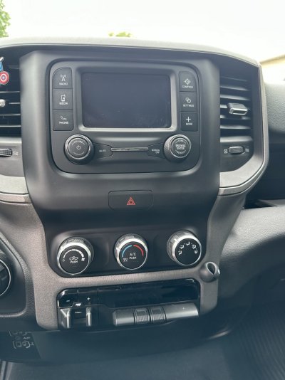

I do have a sliding rear window so I suppose the wiring could be there for the defrosting window to be plugged in. However, I do not have the dash that you showed in your photo. I have the lowest model dash/radio. I can show a photo when I return home tonight.
I think my concern was if I do have the wiring (due to having the motorized window) would they have plugged in the power for the defrosters when I have no button for them. I do not have heated mirrors.

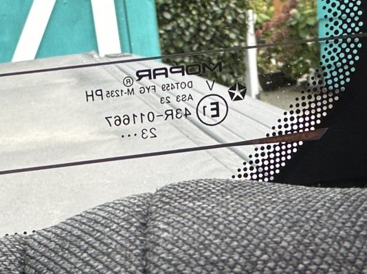

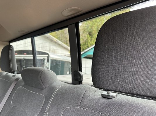

Here are some images for anyone else who might have thoughts on this. I originally had a power slide window but no defrost lines. After the leak I now have a new rear window with defrost lines and no button to turn them on.
Any idea how I could test if they’ve got power?
