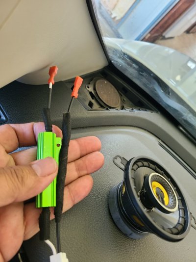

The 6-speaker system in the 1500 is a lil bit trickier than expected; the 3½ dash speakers run off the front door speakers (thru the head unit) and those 3½'s receive a 6-ohm load. They'll be crazy loud to a point where it overpowers the door speakers. You'll need a 4-ohm resistor mounted inline on the + wire to bring the load down (so it doesn't draw too much wattage from the unit). There are some YouTube vids out there to help with this. Hope this helps!

Also, what some Ram owners have done (when upgrading to an 8.4 from 5.0) was to run a 4ch amp to the 4 doors, and remove the resistor from the 3½ dash speakers, and allow them to be powered by the head unit...and use those as additional "fill" reflecting off the windshield. The door speakers will have enough power to blend and tweek to match the output of the dash speakers...

Get the Netaudio harness with resistors. Run new wire to dash speakers to tie into head unit with the harness. No reason to run new wires to the doors, the stock wiring will handle plenty of power for 80% of builds. Now unless you’re going super high end components with built enclosures in the doors with high wattage speakers then it makes sense to run bigger gauge wire. But we’re talking 200wrms per here.

So regarding your inquiry, I did more research (because now I'm motivated to add a 4-CH amp to MY system )
YES, there are TWO options I have found that would work for what you're trying to achieve:
NetAudio T-Harness Loop-Back Kit (which actually isn't as tedious to run as I thought :))
LLJ Customs T-Harness Elite Loop-Back Kit (I like this one, and the YouTube vid they've posted really explains the ease-of-use)
You'd have just ONE (kinda large loomed cable containing all the wires you need) to run back to your amp...and avoid running any wires into your doors! These "Loop-Back" kits are a Godsend...this may be exactly what you're looking for! Check LLJCustoms.com and you can customize the loop-back kit to fit your needs 100%

That LLJ one looks to be "cleaner" for installation. I am curious if you would still need resistors so the factory radio "sees" a load and doesn't stop output to that channel.

I watched a couple of the LLJ Customs vids and they do mention that they have the resistors in their harnesses and I like their available options of using High Level input signal (tighter, cleaner install with the Audio Control plugs) vs Low Level RCA...and I plan on using Audio Control
