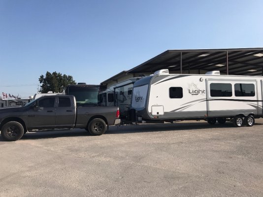

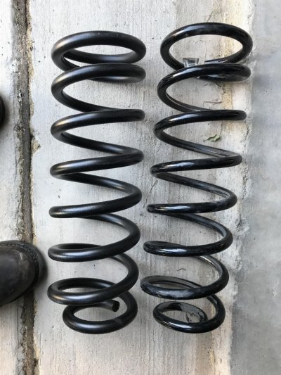

What kind of truck? I ran TuffTruck TTC-1223’s on mine and it did well.
2018 Ram 2500 6.4L 4x4
Amsoil SS 0W-40
Those are solid looking. I have mostly same set up but long bed. How much difference empty do you find the ride? Looks like stock ride height would remain the same, correct? Thanks for the comparison picture. Edit, under that the part number you listed is for a 1500, have you installed the 2500 set on your current truck? I haven't had enough weight in my truck yet to worry, but I always wonder if I added something like this, would it help enough if I had to move my cousin's 5th wheel in a pinch. His trailer is a bit over my capacity and since I have the next biggest truck, if he broke down I would need to help out to get the trailer to say a nearby campground. I could probably squeak by short distance, but would like some extra support for that maybe-never scenario.
AFMoulton
Apr 1, 2016
3,178
5,196
Nuevo Mexico
So I should clarify, that was on my 2016 1500. I currently own a 2500. I was way overloaded with the trailer in that picture and my 1500.
The ride height went up. I leveled my truck with bilstein 5100 at 2.8 in the front, and added the springs in the rear. I don’t remember the exact measurements but empty it raised the rear of the truck about 1.5”. Which was fine since it kept the look I wanted and allowed the truck to handle the trailer weight much better. Ride was much more like a truck, so it lost that nice ride of a 1500, but I didn’t mind at all.
But the wife wanted a bigger trailer soooooo, I now have a 2500. LoL

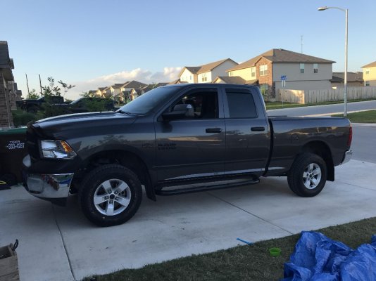

I have sumo springs installed on my truck. We have a 30' trailer and they have helped out a lot. I felt like the rear end sagged A LOT before them. This is with the sumo springs installed.IMG_3150.jpg
