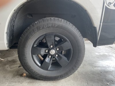

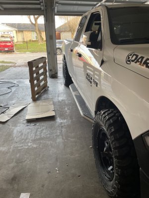

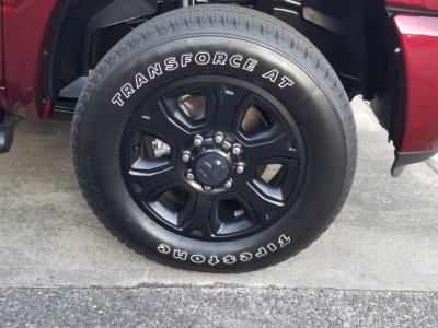

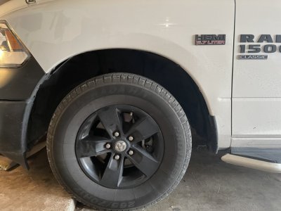

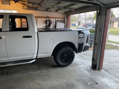

I own a 2019, 1500 classic. This is my second truck/RAM and I recently bought new tires and wheels. I have a question myself. I hope I'm not imposing on Tim1620. I went from a regular truck tire to a mud/all terrain tire. Hell, I don't know what I really have to be honest. Pics 1 and 2 is what I replaced with the new ones shown on pics 3 - 5.
My Concern,
I can feel a slight vibration, The wheels are balanced. My steering wheel doesn't vibrate as it would with wheels off balance. My alignment is straight with no play. I can go 150 to 200 yards at 70-75 mph before the truck has a slight pull (road conditions). Is this the vibration I feel normal, or is this all in my head? I thank everyone in advance for your input.
