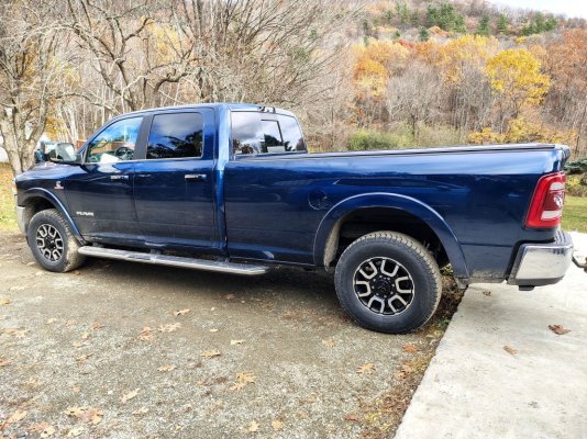

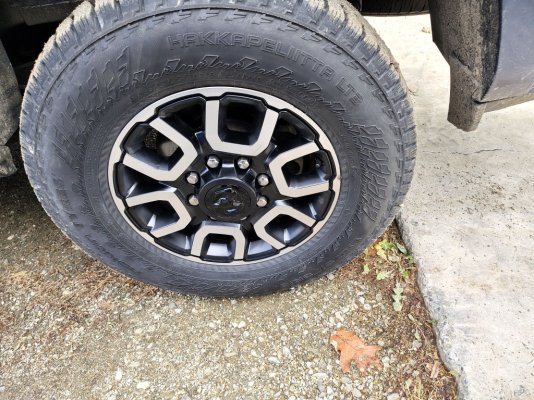

Well got my new studded Nokian Hakkapeliitta LT3 snow tires mounted on my new rims, got the tires yesterday the rims a month or so back and TPMS sensors a week ago.
An expensive little package, tires $1432, wheels $900, TPMS sensor $190 and shinny center caps $70.
But she's ready for winter for the next 2-3 years at least. I hope.
