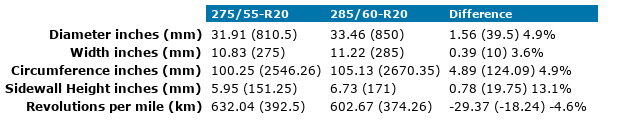

I changed my tires from 275/55R20 to 285/60R20, should I really be concerned about programming the speedometer??

The difference between the tire sizes:
At 70 mph you'll actually be going 73.4 mph
