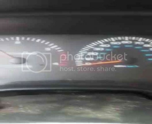

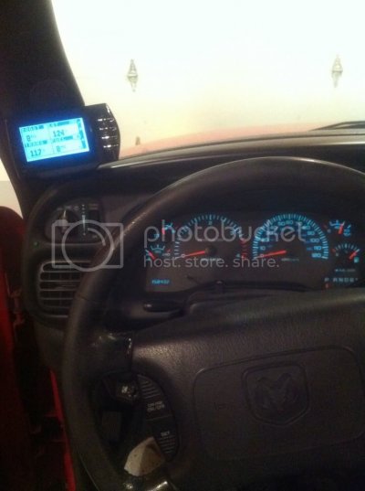

Here is a pic of the tuner ... now there are allot more tuners that I carry this is just the one I was running at the time .
Here is a video I did on that unit with high idle

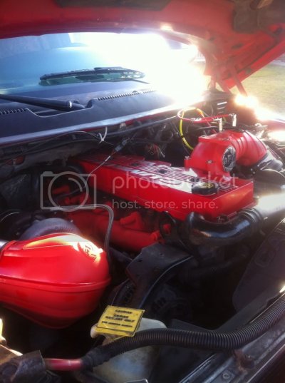

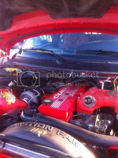

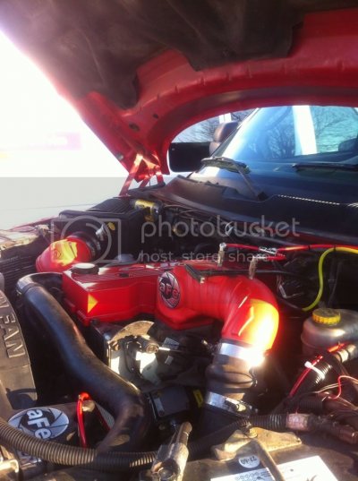

Few pics you can see the power block I had everything heat related plunged into
