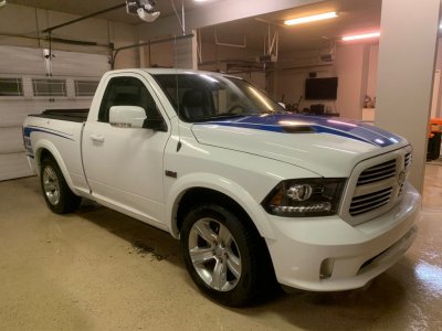

Do you happen to have a name for the original owner,as i thought i knew most of the boosted regular cabs in Alberta,but that one is a new one to me.If you're in Stoney Plain are we gonna see it at Castrol next spring? If you've been around Castrol at all in the last couple years you might know my truck.

Really like that stance. What drop and tire size are you on?
It's basically a 2/4 drop.I'm running narrowed 2" drop spindles up front,and cut down stock R/T springs in the rear. I didn't like the ride i got from MacGauphies (sp?) or Belltechs rear springs,so i went back to the cut down springs i used in my old regular cab. it's running 295/45/20's on the front and 305/50/20's on the rear. Truck is also running the older Illicit cut rear locating brackets,truck works pretty good, it hooks to beat hell,and runs low 12's at 3500ft DA,with a best of a 12.02. This pic shows the rear brackets a little better,if you look at the drivers side rear tire

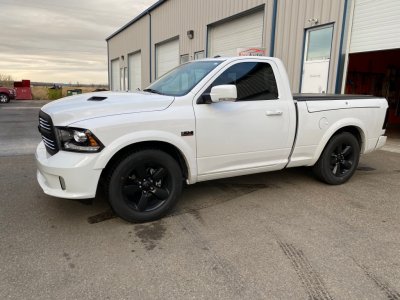

Wild One, I should have mentioned its a 4x4 and I will be daily driving it. The original owners name was Harry. He also had the dealer install a leather interior.
I got it back from the tuner today, the drive-ability is 100% better, the canned tune was bad. I asked for a winter tune, summer tune and tow tune, all moderate with 91 octane. It dyno'd 390 rwhp with my spark plug installation and the canned tune... I doubt it would have done that with the factory plugs. After the drive ability tune it pulled 430 rwhp. I was not going for more hp, just a by product of the better tune. Surprised the previous owner was okay with the drive ability, for that kind of money I would have sent it back!
I received my Icon lift kit today minus the upper control arms, I may just go ahead with that for now as the upper control arms could be 3 or 4 months away. The factory is not shipping anything new for 3 months.
https://www.iconvehicledynamics.com/accessory/11489/icon-accessories-09-18-ram-1500-4wd-75-25-stage-2-suspension-system/
I will resell the Ground Force kit (2 front 3 rear) once removed.
https://www.groundforce.com/part-details.php?part=9984
The fender extensions look goofy but I suspect they will look better once the bigger tires are on. I think my vision will come together once the lift kit and wheel tire combo are installed. I am struggling with aftermarket wheels big time, most of the aftermarket is bedazzled and I like a more purpose built look. Open to any suggestions.
Posted 2 pictures, current and before...

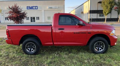

I should add, all black wheels are out, they seem to disappear from a distance and offer nothing appearance wise. Good lesson on these take offs. I will resell once I get the new ones.
I used Rebels on a budget build I did, I thought they looked okay. Similar story, I bought this truck for cheap off a consignment lot (elderly couple). Amazing how much better you can make a truck look with a little love, they could not give this one away !!
