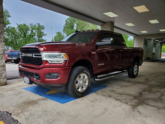

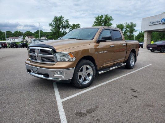

Just now catching this in my feed but I can offer I was in about the same boat until a month and a half ago. Could have stated "ship" but I was Air Force for 22 yrs.
Had a 2012 1500 Bighorn with the 5.7 and 3:55 gears. Our TT is a 26dbh listed as 5900# dry and 725# tongue weight. We've only had this one a year and a few months. Before that we'd been renting through outdoor rec on the base to get a feel for what we wanted. The truck did okay with the towing duties but it's sad when the wife's minivan has a higher rated payload than your pickup. People don't think about it but accessories like side steps and a bedbug liner cut into that. By the time you add up two adults, two kids, an inverter generator, some other gear, and oh yes, the weight of the wdh, I know we were over the limit. Yes, it towed well, but I never got crazy with it. But I'm sure the truck wasn't happy on the long uphill grades in Missouri. Mpg towing was about 8.5. On June 1st with 156k on the clock I made the decision to trade and move up to a three year old 2500 with the 6.4. Diesel might have been nice but I couldn't justify the upfront and at the pump cost. Have only towed the TT once from our storage to house and back. Pulls it better for sure but looking forward to our regularly scheduled camping trips. My issue now is I need a new WDH with a deeper drop or a new receiver shank with the needed drop. TT sits about three inches above level with the WDH at the lowest mount. I made the jump to 2500 because I never wanted to be on the edge with capability.
