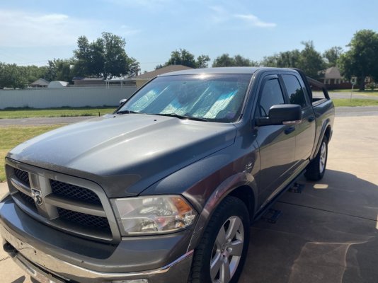

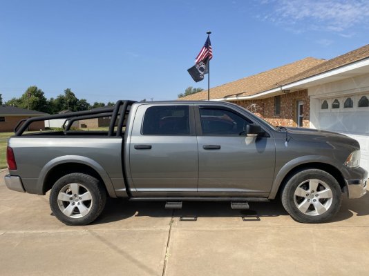

How are your engine oil temps? my 1500 hates me towing anything through the mountains. There's one point on route 87 in AZ where I can't pull a 5500lb travel trailer more than 50mph up an incline or my oil temps will quickly get above 250 degrees. I even experienced 240+ degree temps towing a 1500lb atv trailer on the same road at 65...
actually temps havent been bad, running around i never see over 203 coolant and oil, only time i did see it over was sitting in the walmart parking lot waiting on wife, idling, i saw the gauge climb so i checked and menu at she was at 218, so i shut her down. once i was moving again it went back to like 205. This was in west oklahoma and the outside temps were 106 that day
now the 5.7 has only seen mobile one since new, i do use the oem filters but have always ran mobile one. but then again the tranny has never been touched.
here are a cpl pics, i still love her even with 180k on it.
