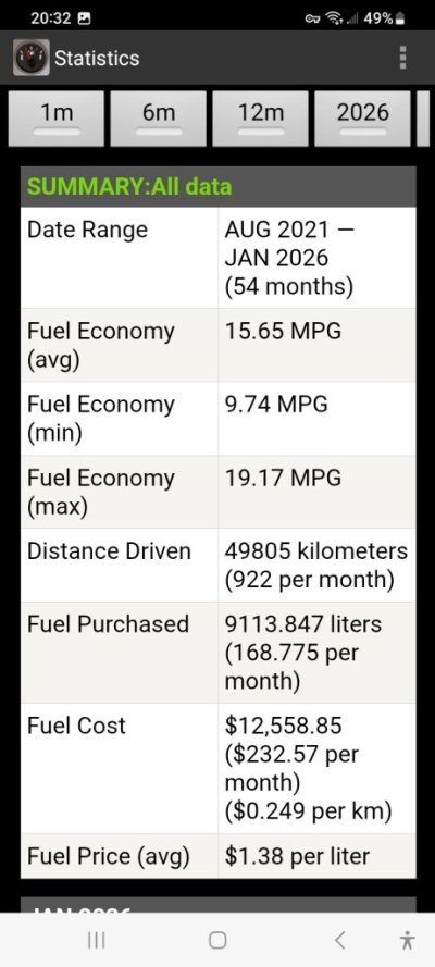

That's crazy. The best tank I've ever had is 16.4MPG on my 6.4 2500 (crew cab, 4x4, 3.73 gears). My highway drives are more typically in the 13-14 MPG range.

Miy 2500 has 3.73s . Hand calculated over hthe 30,000 miles I have driven it over the past 5 years. My buddies diesel gets better mileage towing weight over 8,000 lbs but emply or off road, the gas gets roughly the same mileage. Screenshot_20260615_203222_FillUp.jpg
