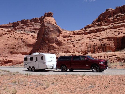

5.7 eTorque, 3.92, 4X4, Crew Cab, 6’4” cab, Smartcap, 11,600 lb. tow capacity, Blue Ox SwayPro WDH, 21ft. Escape 21C with 5,000 gross weight.
8,500 miles and 55 camping nights over the last few months. No complaints.
