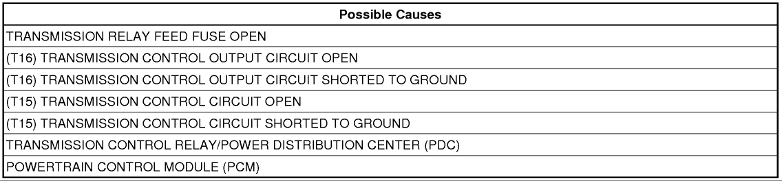

Looking at those codes, it sounds like something in the PDC or wiring to the PDC is messed up. This is the code setting criteria for the PO882 which I think is causing the other 2.
Set Condition: This DTC is set when less than 3.0 volts are present at the transmission control relay output circuits at the Powertrain Control Module when the PCM is energizing the relay.
