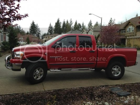

Ok, I just picked this thing up and it is real nice. Purchased from a friend who kept it in the shop never really driving it much. Well its already has a Banks exhaust already.
I bowhunt all over the place and this thing will be pulling a new to me 10,000 lb bumper pull tow hauler soon.
I am looking at the Road Rhino Bumpers front and rear weld yourself as my friend owns a nice welding shop and he owes me some favors. 9500 lbs warn going in it.
Question are as follows seeing as I will be towing should I get a tuner and which one. The truck is an automatic and I am huge on watching tranny temps so do I just get a A pillar mount and drop in a few guages or do I need to get a tuner that will allow me to monitor them.
Second I live and move around in town a lot so thinking of a back up camera or sensors my other truck has sensors and I like them better than the wifes camera in her H2. The camera does make it easy to hook up a trailer though so I know that some tuners allow camera access so combining them would seem to save me some money as a camera mounted with screen is already 350 but the camera itself is only 75.
So open to suggestions on this thing. It already has a nice leveling kit.
Air intake is screwed up on it. The thing has a Spectre Air kit but no air box its just laying where old intake box was. So tons of hot air are being pumped into the filter.
So air in take suggestions would be nice. Do I find the stock box and put it back or spend some money on a Cold Air Intake kit?
Airbags in rear to help with trailer?
Tuner?
If a tuner do I get one with camera option or try to find a sensor add on mod?
How about 2nd oil filter kit that remotes it and scrubs oil better?
Any help would be appreciated. I have three weeks until the wife gets back and if its already ordered then I am good. Otherwise she will spend my truck money on girl stuff. Like a new bed or something jesus.

Nice truck. I would get an H&S mini maxx and get a used OE airbox, it flows more than enough air.
The Mini will have digital gauges to monitor trans temp, boost, rail pressure, coolant etc.
I've heard nothing but good things about adding a remote filter to aid in oil filtration.
I don't know much about the bumpers so I can't offer much there....
check out here 2006-2007 5.9L Dodge Cummins Mini Maxx Street | Diesel Performance Tuners
for more info on the tuner..
Welcome to the site. I am sure others will chime in soon to offer more advice.

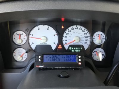

I would recommend a Scanguage 2. Shows temps, reads codes and lots of other things. I have mine set on battery voltage, fuel pressure, intake air temp and water/coolant temp.
