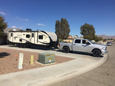

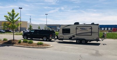

Here is my old truck 2013 15004x4 3:55’s
My new truck 2018 2500 6.4 4x4 4:10’s
Hill climbing you can’t tell the difference between the 2
Wind and stopping 2500 hands down.
Trailer is 32’ 6500lbs empty

The 6 speeds trucks are more than capable. I never wished my 1/2ton had 3.92. I never lacked power.
The comparison to my 3/4ton is interesting.
Both trucks towed the same trailer easily.
I would like to see how my 3/4 6.4 responds to more weight.
