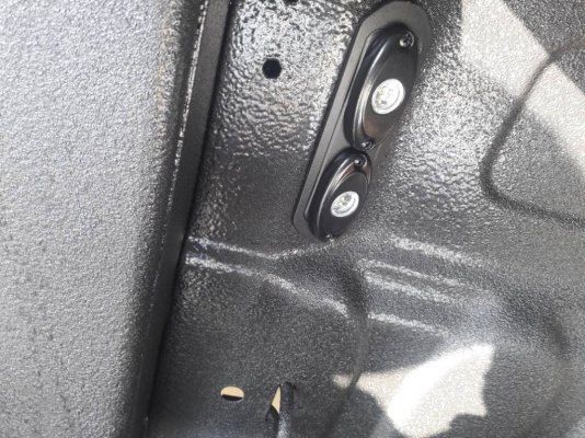

mainard
Aug 3, 2018
41
18
Florida
v8
I bought rock lights $35 and screwed in on the plastic part c39eb3ffb6cda33f3cb449cf208765eb.jpg
