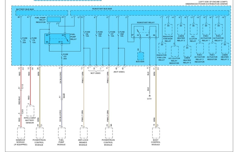

check your fuel pressure with a guage. You should have pressure when you turn the key on for 3 seconds. No pressure, no start. Pressure drops when driving, engine stops. With the key in the on position and jumping the starter relay, if it does not start, it is spark or fuel. Check your fuel pressure when you turn the key. it should jump to close to 50lbs.
Fun fact about that year. The fuel pressure relay is built into the fuse box under the hood. You can not replace it. You have to replace the entire fuse block assembly. It is out of stock and discontinued. Not to fear, it is so common a problem there is actually a company that rebuilds the fuse block entirely. It runs about 600 bucks. Along with the fuel pump relay there are other issues that happen to that box because of heat. \
If it starts it runs. No Crank, flashing security light on dash. This isn't a fuel or spark issuee - it is locked out by the anti theft BS. I already have the fuel pump relay bypass (MOPAR Recall) installed. But it still could be the TIPM.
