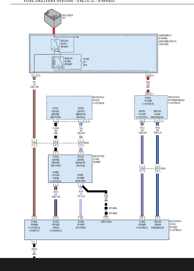

Which wire are you getting 9v on?
This diagram is from my 2013, so it may not be the same. Do you have a service manual for your 2011, with diagrams?
For example, on a 2013, if I was measuring 9v on the "fuel pump control circuit", thats connector c5 pin 17 from the tipm fuel pump relay, the blue/orange wire on the left of the diagram, I'd suspect a bad connection at a connector, loose pin in a connector, a broken wire, green crusties a connector or ground or something. Also, i'd check the ground g916a, the black wire z916
I'd start testing the circuits between the fuel pump relay and fuel pump
Of course, this is assuming that you've already load tested your battery? The old school toaster style from the likes of Harbor Freight work best.
If you can't get a copy of your year models wiring diagram, you might try Alldata DIY.
