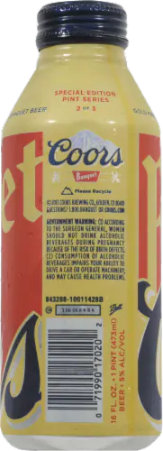

After reading all the BS that the dealerships put out & my own experience with my dealer.
I just took a wide mouth Coors aluminum bottle cap & placed it over the Ambient Light Sensor on the dashboard near the windshield & set my headlight switch to Auto
When i am working, the Law reads that my headlights must be On, so i just leave them On all the time
