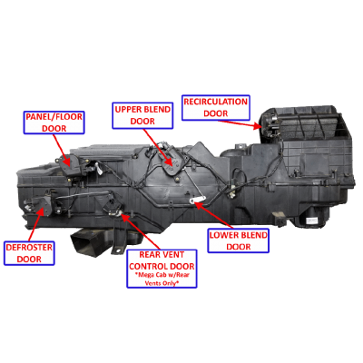

You have 2 hoses going through the firewall
after you have been driving for a while, grab those 2 hoses
1 hose will be hotter that the other, i would mark one some how.
you can back flush using water through the cold hose & out the Hot hose
remember your home water pressure is something like 50 pounds pressure & anything over 7 pounds of pressure in the vehicle can mess things up.
You can use AIR pressure instead of water to help with the Back Flushing
VENTs in the Cab, this is for 2009 & newer Rams, Gen 3 is different
Remove your 2 Glove compartments, caution on the right side of one compartment, there is a spring loaded cord that hooks into the side of the compartment.
Just to the left of the fan, you will see a small motor , called an Actuator, with a metal rod on it
this motor is held on by 2 screws
It is marked Upper Blend Door in the image
watch video
Disassembly of the whole HVAC Box, WITH a full explanation of how it all works
