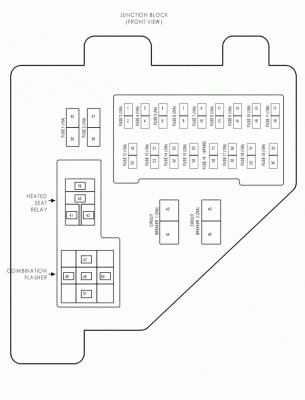

Im sure you looked at all of the fuses in the Power Distribution Center under the hood but did you check the fuses in the Junction Block (fuse box) located at the end of the instrument panel on the driver side? You have to remove the trim cover to access the fuses and you will find the one for the power mirrors and a whole lot more. It will look like this pic.2001 Junction Block.gif

The power mirrors and radio worked perfectly before I changed the switch.
I checked the fuses under the hood and on the end of the dash with a test light. They all show power coming in and going through them.
I cannot find which fuse is supposed to be for the power mirrors, none are labeled as such.
