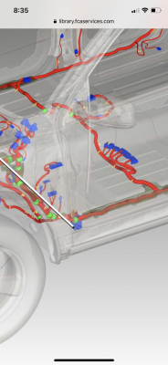

If it’s still not working you’ll have to get out the multimeter and get familiar with wiring diagrams. There is 1 inline connector by the rear of the driver front wheel well, have a leak there as well if you see any damaged or corroded wiring. I attached a picture of its location.

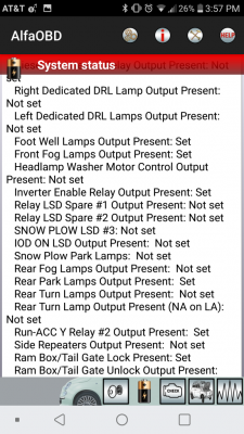

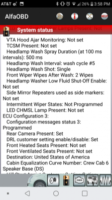

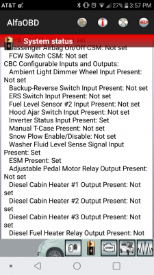

Not sure how the connector under the driver door comes apart. The screen shots below is what I get on the AlfaODB. No codes still. I am going to disconnect the battery and see if that helps if not. Might be time to take it to a shop. Hope its not the BCM.
View attachment 178949 View attachment 178950

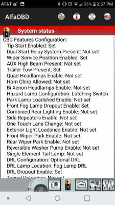

Can you go to your bcm status/ID section (the battery icon) and post a screenshot of the CBC Features configuration section from “tip start enabled” to where LED starts?

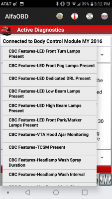

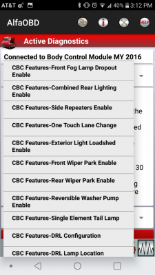

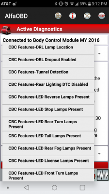

Below are the screen shots. Dont think they are in the right order hard to do from my phone. Let me know what you think or anything else to possible help. Appreciate it
Screenshot_2019-09-04-15-12-51.png Screenshot_2019-09-04-15-12-45.png Screenshot_2019-09-04-15-12-20.png Screenshot_2019-09-04-15-12-12.png View attachment 178987
View attachment 178978 View attachment 178980 View attachment 178981 View attachment 178983 View attachment 178987
You’re in active diagnostics, the area where you can change the actual settings I want to see. Stay connected to the BCM. In the bottom right, instead of clicking on the car with hood open, click on the battery. Then click read system ID. Scroll all the way down to the bottom. Then slowly start scrolling up until you see “CBC Features Configuration:”. Take a screenshot of everything under it (they should all be in one screenshot).

Wonder how that got changed.
Have you made changes to the BCM with AlfaOBD before. If so, You’ll be able to see when that value changed, along with other changes.
