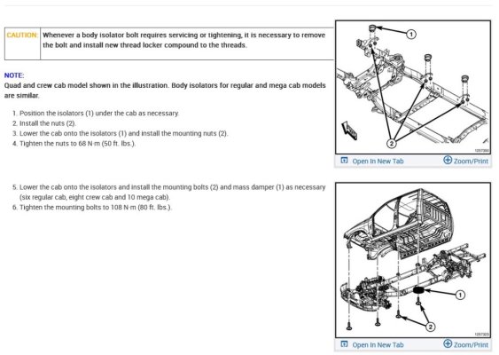

I decided to loosen the driver’s side front cab mount and retorque it.
When I loosen it water came pouring out.
Took the bolt all the way out and then retorqued it to 80 pound feet.
I’m wondering if I should take it back off completely (raise cab a bit) and use silicone on it to seal it so water doesn’t get back into it?
Will drive over that spot later today.

Well I drove across the same spot and the noise is gone.
Basically I think the water was hydro locking the cab mount and preventing it from moving. I think they are hydraulic cab mounts that compress to cushion the cab.
They likely either need sealant or a drainage hole in the lower washer.
