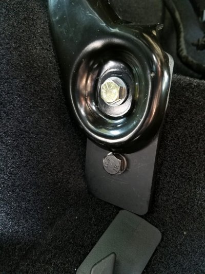

No need for a tutorial because this is quite easy to figure out even though there are no real instructions with the kit. The referenced website above walks you though it but does not have pics. Only the front brackets gave me some grief and they sent me one image that answered the question (basically that the front brackets do not lay flat, they install vertically).

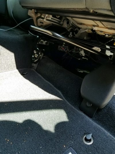

Under the front of the seat. You can see the brackets underneath.

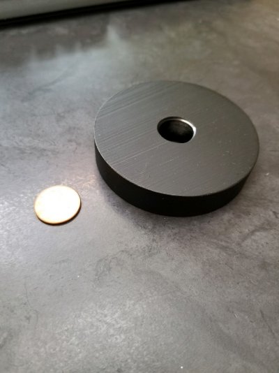

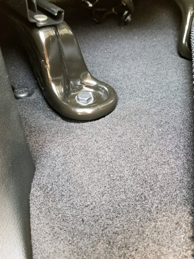

Rear spacers (first pic is size ref with penny). You can barely see them installed under stock brackets in 2nd pic (I only installed one per)
