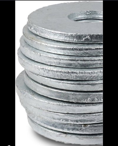

A few years back I used large washer stacks under my rear folding driver side seat in my 2016 Expedition.
Mounted an amp under the seat; didn’t want it to get smashed when power folding the seat. Stacked appropriately 3-4 thick large bolt washers under each mounting point.
Make sure the mounting bolts still have enough threads inside the riv-nut on the vehicle floor to get a good bite. That will prevent hardware from stripping out of fastener.
Btw, wouldn’t be a bad idea to lengthen the bolts so they will grab the same number of threads… this offsets the add height from the washer stack.

The problem with that method is that the front seat mount bolts screw into a surface that's angled. Stacking washers is going to move the seat forward thus preventing the rear bolts to line up with their mounting holes. All those adapters I the picture posted ha e the same problem
