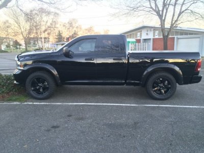

I ran 35s on stock wheels with bils at 2.1 with no rubbing.

Nope
